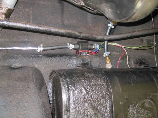

The HOLLEY elec. fuel pump(for back-up & prime). Note exhaust insulation next to gas line and Thermo-Tex 1/2" sleeve around the gas line at exhaust pipes.
