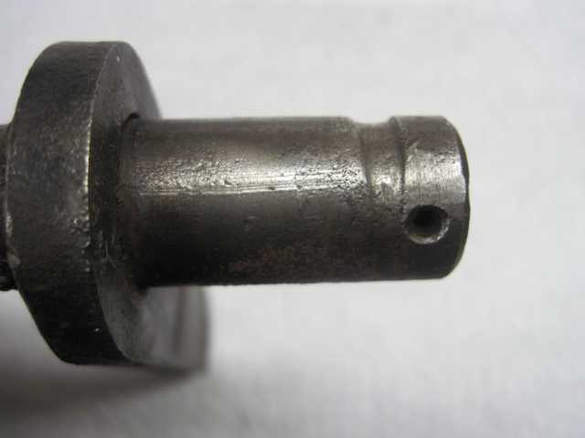

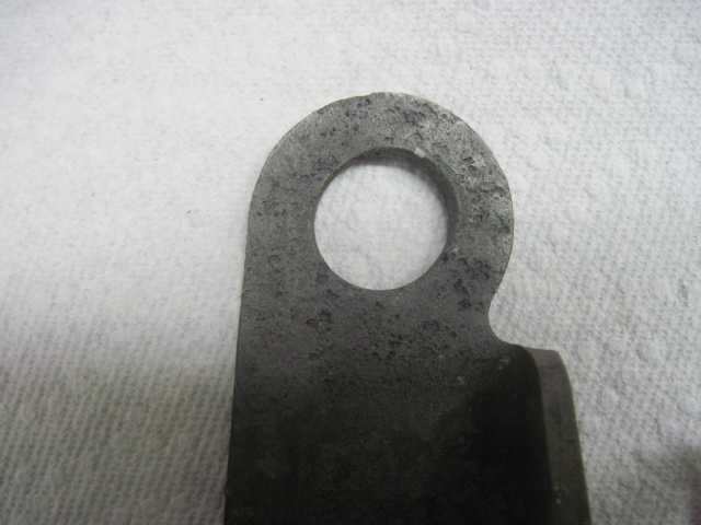

OK, now for my two cents worth. I had a very similar problem with my 1951 Pacemaker. I was 99% sure my clutch was OK as I had put a new one in years ago and the mileage use on it was not exsessive. What I did find (that cured mine) was that the frame bracket for the cross shaft was badly worn egg shaped and the shaft had corresponding groove in it and the clutch pads on the linkage were bad. Welded the shaft and bracket, new pads and all is well now. All the wear made it so the clutch likage could not travel far enough to release the clutch. If you have the tranny out look at the fork that pushes against the throwout bearing and make sure that it is not worn flat sided, it should be a half moon shape. It's possible the collar for the throw out bearing where the fork rides has a worn area in it also. Fix it while it's out. Mine acted just like yours, OK cold go a few miles, could not shift into low or reverse. Shut the engine off, put it in gear, start the engine, then go.
I just added photos of worn bracket, cross shaft

Does anyone sell the frame brackets for cross shaft linkage?
Posted : 26/03/2015 10:20 am
(@Pat Mescher)
I don't' know if anyone does, but unless they are NOS, you're likely to get one that also has the typical hole wear as in the photo. My suggestion is to have a welder slowly build up metal in the lost area, and finish it with file. I did this and it greatly improved the smoothness of motion and reduced the lost pedal travel.
Photo of mine below.
Pat

Eric, it's good to see that you've worked through your clutch problems at last! I'm sorry you had to go through that. Honest, these clutches do work just fine, and for decades. In 40 years of driving my '37, I haven't had any serious problems with mine, though I once allowed the clutch oil to get a bit low and the car didn't want to get out of gear when it was hot. (A clutch fill, solved the problem.)
As to your wish to buy the frame bracket, the "weld" solution may be the quickest, though you could shoot out some e-mails to some of the Hudson vendors who regularly advertise in the WTN. Send along a photo of the entire bracket as well as the original part number. You never know what people might have sitting on their shelves!

(@adamb)
Posts: 320
I bored/ reamed the hole in the clutch cross-shaft frame bracket oversize to accept a bronze Oilite shouldered bushing, which I pressed in. I re-used the felt oil wick, and Oilite bushing is permeable so the oil can can saturate the bronze for excellent long wearing characteristics. The bushing has much more bearing surface area than the original, and will NOT wear a groove in the steel cross-shaft. "OldFarmer47" has posted pictures of this modification I did about 10 years ago.
