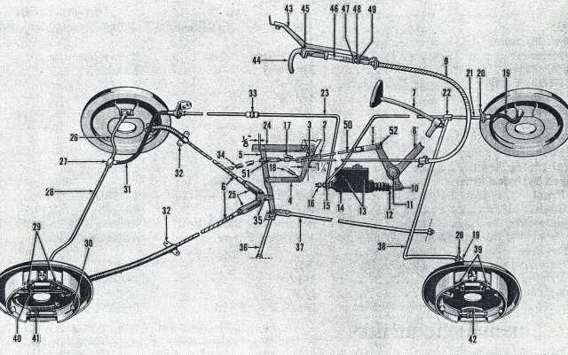

My hornet has one small weak spring underneath for thee brake. The workshop books show three spring. Looks like one long and two short. I am trying to find out the size and length of the springs. I also. Do not have any good images that shows the attachment point. Can anyone provide me information on this. I found a Hudson supplier that had springs but he needed the dimensions in order to help. Any input is appreciated. Hopefully someone has a pic that shoes the proper attachment points. Thank you. Gary

Mine has another attachment point in the body that springs attach to. Have you looked at the shop manual diagrams for your model?

Have a '52 Mech manual and it does show 3 springs{pg 15-2}: #17 Pedal pull rod to guide hanger spring; #18 Brake control lever to guide hanger spring; and #34 Hand brake cable lever return spring.
Now I am confused !! Diagram not very clear but they are all close together. Now I need help ?? Someone with the 3 take a photo.
I really can't see where any other springs might be installed; and it seems to work fine???

Have looked at this again today (have car lift so it is easier to do than most). The spring #17 is the only one I have. Spring # 34 goes between the hole in arm back to a welded tab to the rear seat floor--probably 14" between mount ends; this is to retract the Emer. Brake when released so it couldn't be too strong or it would be too hard to pull the handle back. Spring #18 is a mystery; there is a small link with a spring hole on top of the bolt where it attaches to the arm BUT I cannot find exactly where it hooks at the other end. I will look for a medium spring at Ace for #34 and then use a connector wire, etc. to make sure the system releases. Maybe someone can advise where #18 connects on the other end.

Parts book indicates that
#18 is a "Spring - control lever to hanger-less PB." PB are power brakes. Part # 300916
#17 is a "Spring - pull rod to hanger-less PB." Part #300914
#34 is a "Spring - cable return." Part # 302169
18 and 34 attach to a small "hanger" These are little metal tabs that are held on with a cotter pin on one end and have a small hold for the spring to attach to on the other end. Don't have a picture of those. YOu should look in the online literature if you're a member and go to the 48-54 master parts catalog and you'll see a better picture than the one posted here out of the service m have a hard copy myself. It can be very difficult to find springs with the correct tension at a parts store. In many ways, you're better off if you can find some decent ones off a parts car. Check out the people in the club who sell used parts and they probably can help you.

This is the first time it seems to have stumped the club. Maybe someone has an undisturbed original or parts car and can get a pic that shows the original springs and an estimate of the sizes. The drawings is really unclear on the attachment points and I hate to guess on something like my brakes.
