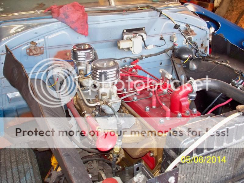

The reason im here is that when my father passed away I inherited his 1953 Hudson Hornet. he purchased this hornet in 1973 after his beloved 57 ford was destroyed by vandals. dad worked on the Hornet for several years until he got side tracked by having a family. once we were old enough that he could resume working on the Hudson he became disabled and wasnt able to do much of anything on it. I dont know much about the car so im hoping that you all can help me to learn about it.

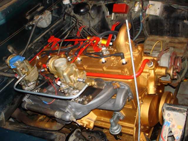

the things i know
the block is Bored .040 over.
it has light weight Jan's racing pistons.
it has what was the highest performance cam available at the time.
Is equipped with Twin H
Has a 232 head installed for higher compression.

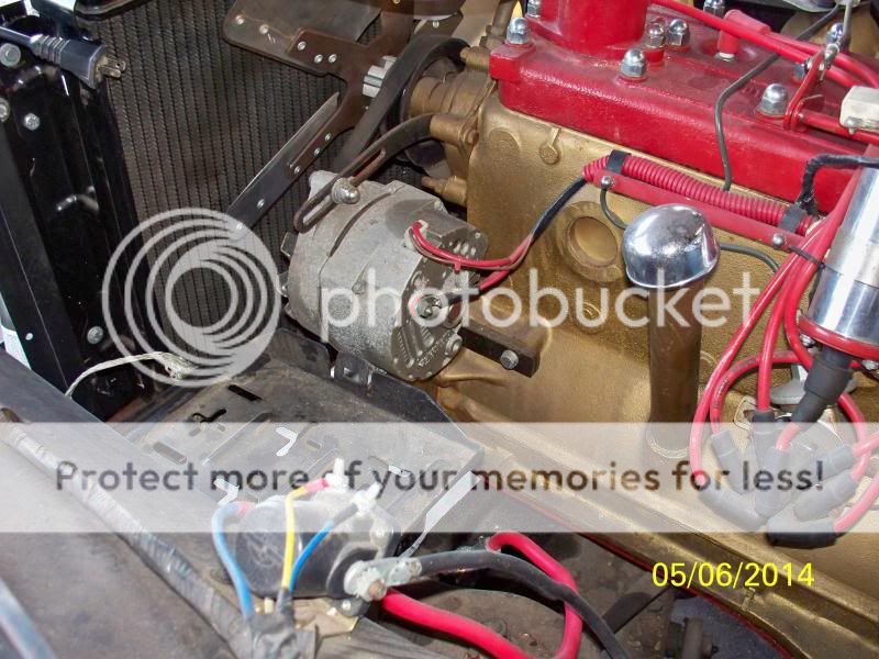

dad also converted the car over to 12 volt for convenience

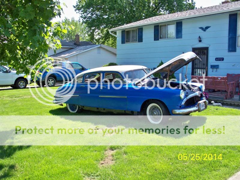

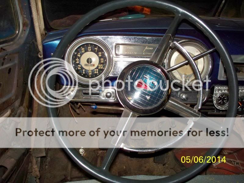

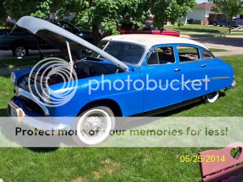

over the past 4 weeks my brother and i have gotten the Hudson from a pile of parts in the garage into a drivable car. its still far from finished but its the only Hudson Hornet in my City. though there are 2 other Hudson in the area that i know of a 48 Commodore and a 54 Jet.
Here are a few pics of my Hudson.

Thanks for the welcome and the info about the other forum. I'm excited to be working on this car and getting it ready. The one thing I'm trying to learn is how do the oil bath air cleaners Mount to the engine? I know how they Mount on the carb but where do the brackets that attach to the head sit on the air cleaners?

John, the oil bath twin h air cleaner brackets are different than the non oil bath air cleaner brackets. The brackets dont look hard to make so I plan to do this for my air cleaners. The picture shows the postitioning of the brackets and believe they just bolt to the head. Wish I had a better picture and some demensions but this is all I have to go on myself. Doug

Thank you for the info, the brackets I have don't look like that. I'll have to find some or make some. One thing I need to know is how do the brackets attach to the air cleaners? Or do the cleaners simply just sit on the brackets.

The long through bolt that holds the filter parts together must be loosened a bit. The brackets slide in between the bottom of the base and the large washer. Hope that makes sense!

Yes, you see the u shaped opening at the end of eash bracket, that would slip under the bolt head and washer on the air cleaner just described by Ric above. Doug

That makes total sense, looks like I'll be making some brackets soon. Thanks alot for the information.
