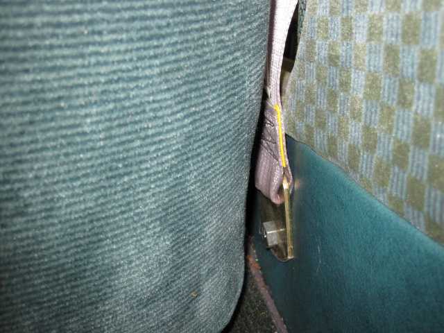

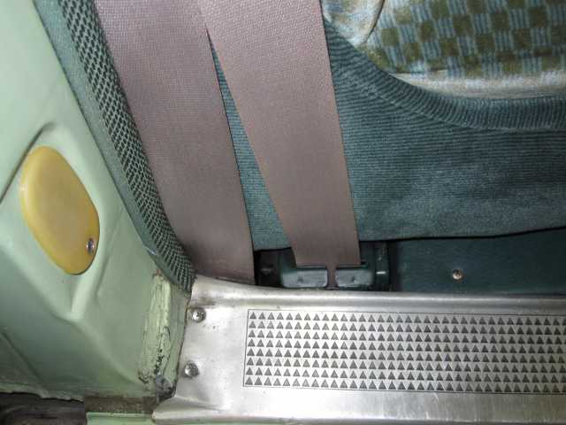

More info: brand is Beam's Industries OKC; Ft seat 3-pt. is #WSCH324; rear seat lap belt #1300.
other photos below>>
first one shows retractor mounting and end attachment beside it{end attachment also shown in last photo)
the next one is taken from the back seat showing attachment at the floor area for pillar side belt

I would recommend a blind nut be welded to the pillar rather than count on a lag bolt to stay in place- just a safety concern.
