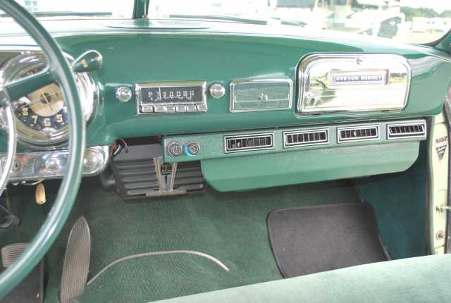

(@Richard Dryman)
Vintage unit in '53; not hidden but cools entire car.
Posted : 24/04/2014 1:34 pm

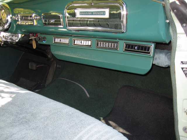

(@Richard Dryman)
Additional in car photo and photo of compressor.
Posted : 24/04/2014 1:38 pm
(@kevinjets)
Posts: 358
Richard, that is the same unit we have in our 53..Still have full use of the heater, and the compressor is just like yours. Cools the complete car and Margaret has to put her heavy sweater on. Going to Oklahoma, 113 degrees, it kept the car at 60 degrees. Vintage Air in Texas. One thing I found, just crack the vent open and it works better, blends outside air, just like all cars that have air. Walt.
