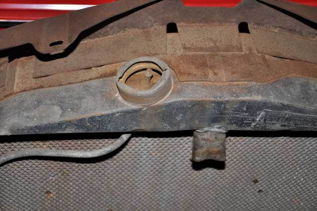

Here's a closeup of the top of the 1933 Hudson Radiator. It has the Diamond pattern that David mentioned. I know I've thought of that as kind of a honeycomb pattern, but his description is really more accurate.
I have a 1942 De Soto club coupe which has a radiator with more of a honeycomb pattern. I don't think that was uncommon in cars until about 1949, then radiator design changed as the postwar cars changed, probably mainly as teh engines started to get bigger and needed cooling improvements.
