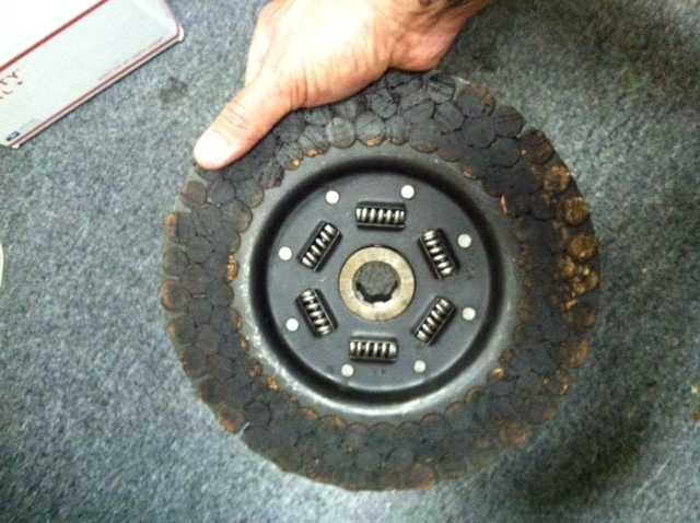

If you check the following pictures, you'll see the worn clutch disc and The OG input shaft trans is scored.
Actually the problem doesn't occurs more when it's hot. It occurs after multiple take offs, cold or hot. I can clutch/declutch a lot of times at idle and without charges with no problems. Then if block the rear wheels and try to start, the engine will need more and more RPM to keep running then dies. Then the clutch won't release from it's position.
Can it be caused by a faulty clutch disc ?

Thibault, what is the thickness of the disc?, this measurement is cridical. Also, did you check the height of the fingers before you dis-assembled it ?. The shop manual states very clear what the allowable tolerances, are .No less than 1.250 to 1.500 maximum depth installed height of the fingers. If they are more than that, it can over-travel the clutch fingers, letting them go against the disc and can cause it not to release, harsh engagement,, not at all,clag-banging,
